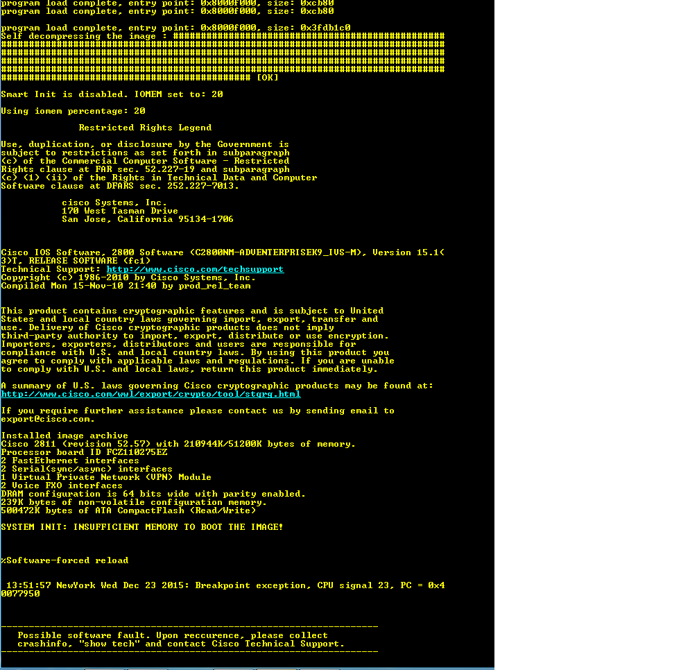

I think there is less memory in router since the image which u have loaded on router  requires 512MB DRAM while u have only 256MB .
I have attached the snapshot.

Your attachment indicates the cause of reload to be  'insufficient memory to boot the image.'
it can also be seen from the logging shared, look for the line mentioning "Pool: processor Free:... Cause:Memory fragmentation.
have a look on the below links for understating and troubleshooting on the same.
https://supportforums.cisco.com/document/11776/router-fails-boot-and-system-init-insufficient-memory-boot-image-error-message
http://www.cisco.com/c/en/us/support/docs/ios-nx-os-software/ios-151m-t/116467-technote-ios-00.html
