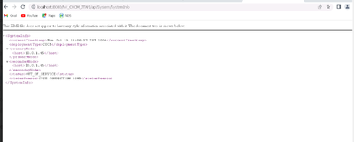

Dear Community,
When I hit my API on the browser in the same network, it shows that my CUCM is down. However, my CUCM is up and reconfigured. Please suggest some resolution for this issue. Attachment below.

 My UCM is working and my CUCM server was crashed so I reconfigured it, and it is working fine, but when I run my API, it shows that CUCM is down. Otherwise, my extension is working fine and everything goes well.

Version;- CUCM 11.5
The "Out of Service" message is a 503 error, which means that the CUCM server received what it believed to be a legitimate request but could not respond.
You said your "CUCM server was crashed so I reconfigured it". Did you make sure to configure it to respond to this API? For instance, is the AXL API user is configured and is using the same password as before?

i configured same as before it works and also activate the AXL service in it.

Now at present it is working from one side If I run with 10.0.1.45 to 10.0.1.55 it is showing down but when I do vise-verse it is showing working basically on checkthe systeminfo to run the URL HTTP://10.0.1.45/api/system/systeminfo.
@Nikku , so you're saying if you try and run the API on the publisher it works and shows in service, but if you try and call it on the subscriber, it shows out of service?
yes sir,

My CUCM is up But my jtapi is not working, that is my issue
