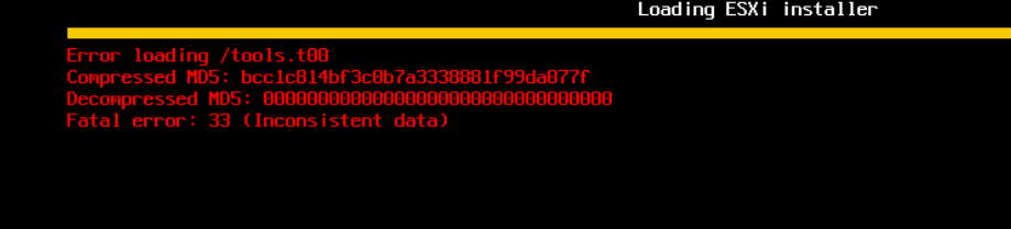

Wow, I'm getting a fatal error while trying to install an ESXi
Is there something I'm missing on the Service Profile that should be done ?
That error indicates a bad MD5 hash on the image it appears. I would ensure you are installing with the Cisco custom ISO image of ESXi.
Yes, I did used the Cisco custom ISO
It happened only once, strange
Now it's working
Thanks again guys
