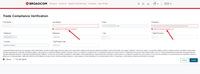

Edit #2:  This is very frustrating. Broadcom's website is horrible. I had to use Firefox to get the menus to load correctly to get to the correct area to download, THEN it forced me to update my information (it was incomplete) before it would let me download, BUT I only had the first letter of my last name added originally and the full company name they imported from VMware for my profile when my account was created and that name is more than 40 characters in length which apparently is over the limit for what Broadcom allows...and...guess what?...you can't edit this info. It's grayed out. I opened another tab and went to my profile to see if I could edit it there, but the company name isn't even in the profile (no field for it) and it won't let me update my last name. There's no address info there either. Unbelievable.  Fortunately, I found a copy of the ESXi installer on another old server we have, so I downloaded it from the server's datastore. *sigh*
