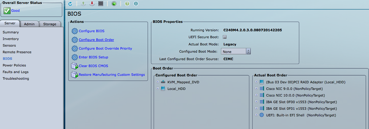

What I'm actually looking for is this page from the CIMC (as it lists the boot order for the server). [see attached]
