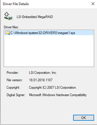

Hi @RamblingPSTech   No luck unfortunately.  Here is what I'm seeing.  Slightly different from @orcun usturali ...
Just closing the loop on this.  Finally stumbled across the solution (thanks to your help).  Needed to run the SetupChipset application located here from the iso you sent:
D:\ChipSet\Intel\ChipsetSoftware\10.1.18435.8224
That did it!
Thank you @RamblingPSTech
That HardwareID matches the LSI Embedded MegaRAID controller. The drivers `Storage\Intel\C600\<winver>\x64\megasr1.inf` should be the correct one. It does look like the Intel C600 storage controller driver was removed from the 4.2 Windows Cisco driver bundle, but does exist in the most recent 4.1(3r) NOV2021 release at the time of this posting.
I do not see any comments in the release notes for 4.2 regarding the reason for the removal of the Intel C600 Storage driver or if there should be a different driver used instead.
