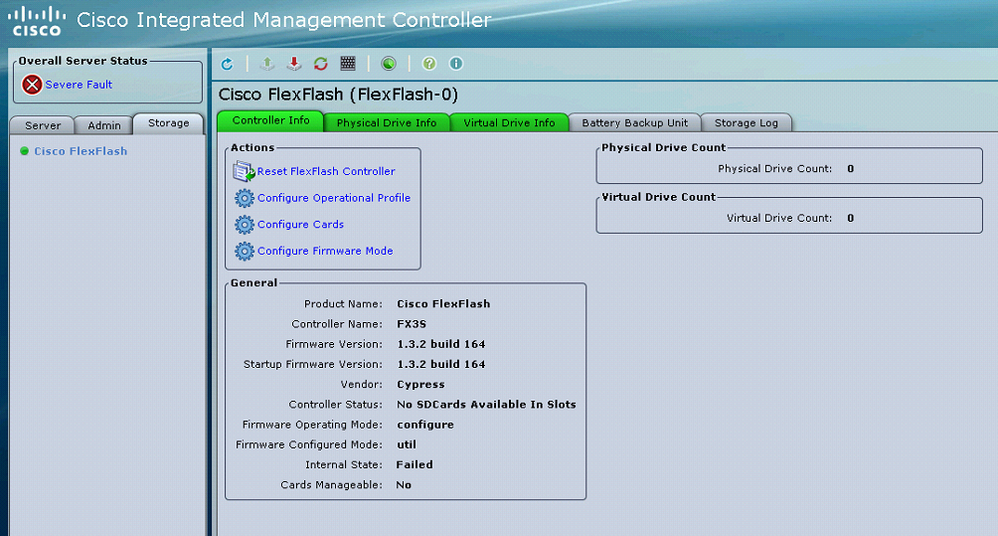

Dear UCS expert,
It is because browser is not supported Flash, so I upgraded CIMC with firmware & BIOS version to support HTML5.
After upgrade, the UCS C240 M4S2 No Storage Disks & Only Show FlexFlash.
Even, I made it fall back to downgrade CIMC, firmware & BIOS as 2.0(10l), and I got the same situation No Storage Disks & Only Show FlexFlash.
Any ideas? RAID Card dead?
Edwin

in captures, i can see red 'server fault' for server status. can you share the server status screen
Good luck
KB
Just showed FAN issue
