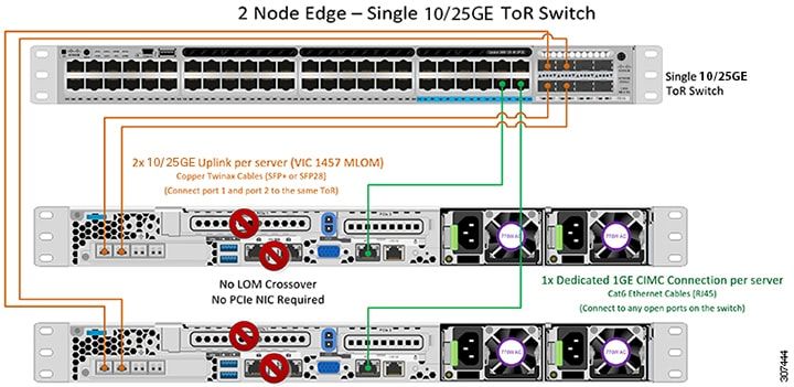

The strange thing about Hyperflex Edge is that it actually has many more options (and many more ways to make mistakes) than HX INstall using Fabric Interconnects.  In your case, you have your HX nodes connected to a 9300 using 10Gbps Ethernet on the MLOM.  This means you config should look like this:
307444
The above diagram is just one of many from the rather confusing HX Edge deployment guide. I say confusing, because it is sometimes difficult to see where the document stops talking about one kind of deployment and starts on the next.  Now doubt you have already found that document, and possibly found it more confusing than I did.

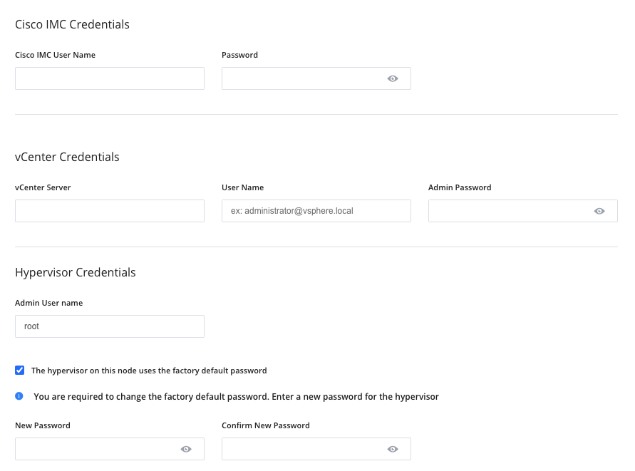

But there you need a login and password for vCentre and UCS manager.
That should NOT happen if you have chosen Edge Cluster from the installer menu
HOWEVER - you will need to know the IP address AND username and password for the Cisco IMC for each HX node. That's the green cable in the diagram above. Once you have selected Edge Cluster you should see:

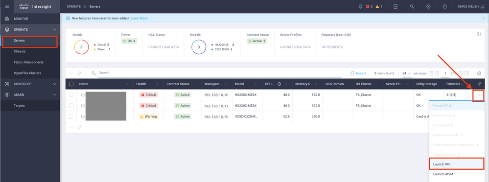

There are two ways to access the CIMC, via Intersight and directly to the CIMC IP address,
Hopefully the cluster was set up with Intersight access, which is by far the easier.
  1. Log into CIsco Intersight https://intersight.com with your Cisco ID
  2. Select Servers on the left hand side.
  3. Find the Server you want to manage, and locate the elipsis (3 dots) on the right hand side and click it
  4. Select Launch IMC (Note - you will need to be able to access the IP addresses listed in the Management IP column to do this
The second method is to navigate directly to the CIMC Management IP address for each server (as listed in the Intersight view) and log in as user admin and your admin password as configured when the servers were installed.
307444
