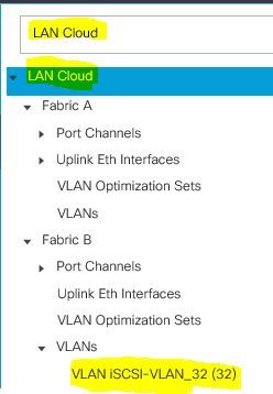

I have created a Fabric B specific VLAN (32).
Why does it not appear in the available VLAN list of the new VLAN Group I created ??
VLAN 32 is NOT assigned to any vNICs yet.
The new VAN group (iSCSI-B) has no "Ethernet Uplink Ports" nor any "Port channels" added yet.

Are you adding the VLANs under the LAN Tab > LAN Cloud section or LAN Tab > Appliances section?
The VLAN is created under the LAN Cloud.  No appliance VLANs.
