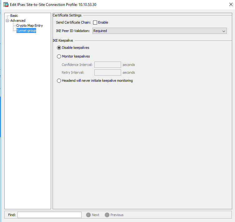

03-12-2019 10:20 PM
I checked the 2 firewall and the result show below:

03-12-2019 11:00 PM
The Keepalives seems correct. What about the Phase1 and Phase2 timers?

I didn't found any mismatch in the configuration. Please disable the keeplive on the remote site.
If you will face the issue then please share debug output.

Thank you for your replay,
In this time i'm applied the change in TX site and set to "keep alive disable", After that i'm waiting if any issue back again and i will capture the debug output to you, (Correct me if i wrong),
I will show you with photo below and in this ASA was TX site because no TX packet but we have RX packet, We have issue in TX site with 10.10.53.12 (TX site), And the 10.10.53.30 (RX site).

Whats your ASA version? There were multiple bugs in the earlier 9.x versions where the ASA would just stop encrypting for certain SA's. The only way to recover from this is a reload. I recall the problem was stale entries on the SA Database. Can you reload the faulty ASA during a window to check this?
- Mark as New
- Bookmark
- Subscribe
- Mute
- Subscribe to RSS Feed
- Permalink
03-27-2019 08:12 AM
Bugs:
https://bst.cloudapps.cisco.com/bugsearch/bug/CSCup37416/?rfs=iqvred
https://bst.cloudapps.cisco.com/bugsearch/bug/CSCvb29688/?rfs=iqvred
Looks to be fixed in 9.7 and above.
