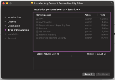

I'm trying to install Cisco AnyConnect VPN on a Mac (version 11.7.10), but I can't get past the "Installation Type" stage. After accepting the licence, the "Destination" step is skipped and I go straight to the "Installation Type" step, but I can't select the options and therefore can't continue with the installation (see image).
Also note that : I had already installed this VPN, but I hadn't selected the right packages (I just had to choose the VPN). So I tried to uninstall Cisco, then reinstall it. That's when I encountered this problem. So I tried deleting its network configuration and all residual files (trying to find them all), but the problem persists.
Has anyone encountered this problem or know of a solution?
Thanks a lot!

balaji.bandi
what is the version of AnyConnect ? did give you option to select the checkbox ?
check this guide :
https://www.cisco.com/c/en/us/support/docs/smb/routers/cisco-rv-series-small-business-routers/smb5642-install-cisco-anyconnect-secure-mobility-client-on-a-mac-com-rev1.html
BB
I believe it's a 4.10.x, but it did not give me the option to select any checkbox the second time I tried installing it... So I am stuck at step 9 in the guide haha

There is an Mac App call AppCleaner, which you drag the application that you want and it goes and clear and remove all dependencies, very usefull to have a clean system without orphan files from previous applications removed from the system

Thank you ! I should have used this when I first uninstalled cisco... (too late for that now)

    Run this from MacOS terminal (recommended to also perform a reboot afterwards) and you'll be able to re-install and choose your options: sudo pkgutil ‐‐forget com.cisco.pkg.anyconnect.vpn
