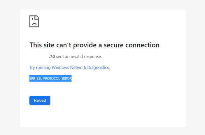

This is a lab box, on a bench with a flat 192.168.1.x network and g0 is connected.  Not connected to the Internet.  Can ping g0 from local subnet.  When we try to browse to it, we get "The connection for this site is not secure".  This actually worked six months or so ago.  Not sure what changed, but it sure sounds like a date somewhere, but cannot find anything.

I followed that link, configured Chrome. I could browse to a lab 3504 on the same subnet, but when I try to get to the 9800, I get this:
This site can’t provide a secure connection
192.168.1.250 sent an invalid response.
* Try running Windows Network Diagnostics.
ERR_SSL_PROTOCOL_ERROR
I tried Scott's recommendation but it did not work.
