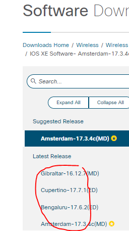

interfacedy
Please see below screenshot where there are several ios 16,12, 17.7.1 etc. The version 15.3 that we are talking about above is the same term system? Thank you!
You are jumping from AireOS to the 9800's.  The easy way to look at this is, if you are using a controller AireOS or the 9800's, then only focus on the controller image and not the ios image.  If the ap's are compatible with the image on the controller, then the ap will join.  If the ap is not compatible, well you know the answer to this.  I don't want to confuse you more, but you don't need to know the ios image unless you are really having problems or trying to do something not standard.
AireOS image is 8.5.x, 7.x.x, 8.10.x, etc.  You see the pattern.
IOS-XE 9800 image is 16.3.x, 17.x.x, 17.7.1.
-Scott
