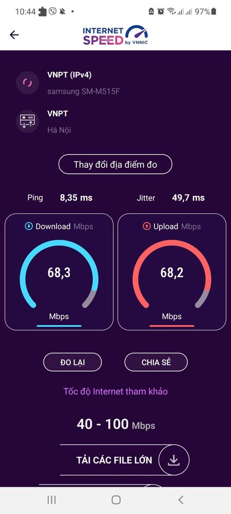

Currently, we are using Cisco Access point 1560 Series for Free Wifi Project.
We have a problem: the use of SFP port will double the speed of internet access via AP with the same network configuration. Please help explain this reason. Thanks.

Using of SFP Port for data and LAN Port for power:
And using LAN Port for data and power:
@tranghuyennguyen34 wrote:
I am comparing the use of SFP Port for data and LAN Port for power vs using LAN Port for data and power.

Thank you so much! I am comparing the use of SFP Port for data and LAN Port for power vs using LAN Port for data and power. Speed test each time gives different results:

Thank you! But we don't use radio for the backhaul. I am comparing the use of SFP Port for data and LAN Port for power vs using LAN Port for data and power. Speed test each time gives different results
I don't know why
