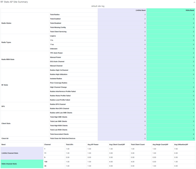

Here are the results.
In the AP Message Summary, I discovered this message...
It's strange because both APs are connected to a Cisco 9300 switch. I don't understand why it tells me that AP 1 is in 100mb mode!
Ethernet: AP has Interface on 100 Mbps mode. Please validate that this is intentional.
APS: C9120AXE-1
Action: An interface at 100 Mbps could point to negotiation issues with the switch due to cable length, errors, etc. This could lead to significant impact in stability. This could lead to significant impact in stability and performance
How can i fix this problem?
What do you think of the other results, as I won't be interpreting them too much?
