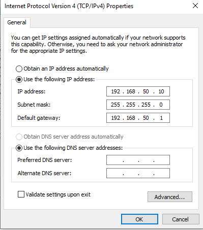

I am a complete beginner.
I'm struggling a lot trying to access to the WLC 2504 using the GUI.
I can configure the controller using the console port, but I cannot access it though the GUI.
I set the Management IP address as 192.168.50.10 but when I type this address in the browser, the "web page not found" message comes out.
I've tried disabling the WIFI adapter as well as using a cross over cable but it made no difference.
I also have a 3502I in case I can access the GUI viawireless but anyway, I am not able to see its SSID.
Thanks a lot for your support !!!!
the screenshot from your PC and the output from the WLC show the same configured address  192.168.50.10 !
You cannot use the same address for two devices that need to communicate with each other.
-> assign another address like x.x.x.11 to your computer
>>> Ethernet and my WiFi adapters enabled at the same time <<<
there could be a BIOS setting like this one that switches WLAN off when LAN connected.
it could also be because of using an address already in use by the WLC -> try with another address first
of course this depends on  vendor
-> look in your computers manual what setting to change
Thank you Haydn,
I am connecting the port 1 of the controller directly to my ethernet NIC on my laptop with a straight through cable, no switch in  between.
I don't manage to see my Ethernet and my WiFi adapters enabled at the same time.... maybe that's the issue.
I have tried on another laptop and also disabling the WiFi adapter but without success so far.
