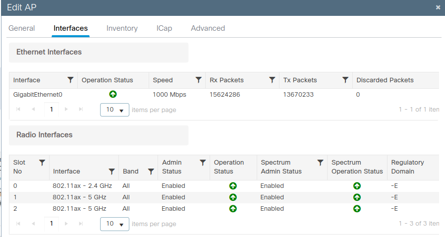

3. On the EWC clean air does not seem to work.  "Specture Operation Status" stay down even though it is enabled.  The controller does NOT show any interferers, ever.

For me 17.3.4c and 17.3.6x all works fine and displays statistics.

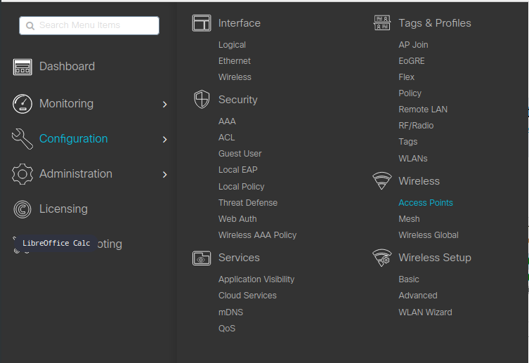

The only thing I haven't noticed before is I was missing the Radio configuration section on GUI.Missing Radio ConfigMissing Radio ConfigCleanAir Interface StatusCleanAir Interface StatusCleanair StatsCleanair Stats

This is a mixed environment with C9130 and C9120, but C9130 is the primary controller.
After consulting TAC about Radio configuration missing, this is a known defect on 17.6 train which is been fixed... maybe your issue is related to this so open a TAC case.

Interesting - I don't have the Radio Configuration missing issue in either 17.6.3 or 17.8.1 - my environment is mixed (C9130AIX and AP1562).
