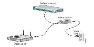

Sorry for my ignorance....Is this what that installation would like that or are there other ways to install?
That's correct. AP powered from injector which is sit in between switch & AP
Rasika
Rasika
