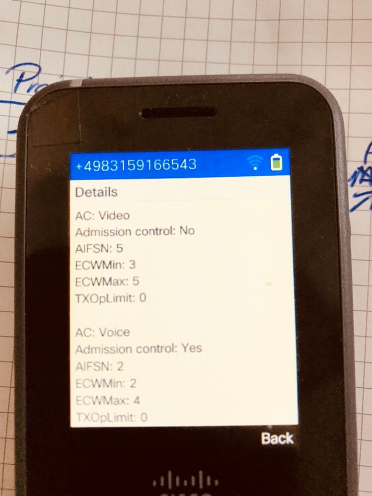

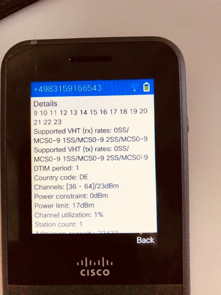

start the phones WLAN Diagnostics
this shows the phones information/capabilities
and also the rates offered by the access-point(s)
what I read from this output:
so the AP requires Basic rate 12 and accept optional rate 18, 24, 36,48,54
the phone supports HT  (=802.11/n)  rate 0 - 23
the phone supports VHT (=802.11a/c) rate 0-9
=> match on /n but no-match on a/c !!!!!
