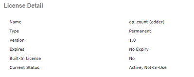

I followed the steps in the documentation, but the options do not appear either via the CLI or the GUI.

The screen above is from the same version as yours

 On the screen you sent, click in License type please. If the license type is RTU, like the example below, you indeed dont nee to worry with the factory reset.
For more information about this kind of licensing, check the link below
https://www.cisco.com/c/en/us/support/docs/wireless/3504-wireless-controller/214106-licensing-on-3504-5520-and-8540-wireles.html#anc4

3504 is just a RTU adder license, so should be nothing to back up, just add the license back after reset.
I understood,
But if I don't have the information to add the licenses again, I don't have the right way to add them?
