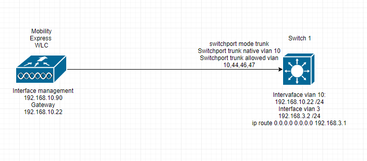

Hi everybody;
I have the following question, i just installed and configured WLC controller with 7 AP's, the management interface have the ip address 192.168.10.90. i am able to ping the interface vlan 10 (internally is the management vlan) of switch 1 (192.168.10.22) and even i am able to ping from WLC whatever ip address from managament vlan of all of devices of my network. I tried to ping my radius server 10.102.100.1 too, but in this case i am not be able to.
On switch 1 i can ping the radius ip address 10.102.100.1 , and also i tried ping 10.102.100.1 source 192.168.10.22 and i can ping.
What could it be the problem??

If i connect a Laptop Directly to the switch in vlan 10, i am able to ping to whatever side.
The switchport configuration is the same like i put in the scheme.

So you mean to remove switchport trunk native vlan 10 from switch and tag the management interface of controller with vlan 10 ??
Kind regards.
It depends on your setup, but essentially yes try this for testing.
