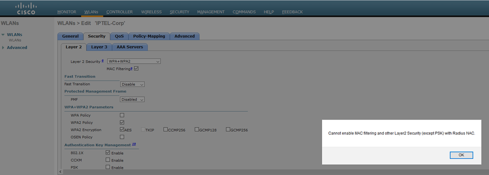

I found the solution:
In the controler SSID select MAC filtering.
authentication rules:
1- 802.1x and use:AD
2-MAB and use: indentity endpoint
in authorization:
1 rule: Identity: AD and 802.1x
2 rule: Identity: Identity group endpoint and condition MAB
result both the same.
the first process, as I select the MAC filtering in the controller, are the rules with MAB, and later use the 802.1x.
if one of them fails. can't access!! :)
thanks!! :)

Did you set this up in your lab? How does the controller do MAB and 802.1X on the same wlan profile? I didn’t know it was possible to mix the two auth methods.
yes, not in lab, in production. is a new SSID.
the SSID is a WPA2 entreprise, so is 802.1x, but if you select MAC Filtering in the SSID (security) the controller first send the authentication/authorization for the MAC, and later the 802.1x.
Is working fine.
I just tried this on our Cisco virtual controller (8.5.131.0) and I had to turn off the Radius NAC in the WLAN in order for MAB to be enabled at the same time.   And yes this is pretty amazing - thanks for pointing this out.  I am wondering what this Radius NAC setting does ...  ? Because we just blindly set this according to all the docs ... now 802.1X and MAB work just fine without it.  I think I am about to learn something new ... do you have any clues what this is for?
