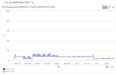

Here are the outputs:
9800-Pair1#sh platform resource
**State Acronym: H - Healthy, W - Warning, C - Critical
Resource                 Usage                 Max             Warning         Critical        State
RP0 (ok, active)                                                                               H
 Control Processor       4.31%                 100%            80%             90%             H
  DRAM                   9816MB(15%)           62891MB         88%             93%             H
  harddisk               0MB(0%)               0MB             80%             85%             H
ESP0(ok, active)                                                                               H
 QFP                                                                                           H
  TCAM                   78cells(0%)           1048576cells    65%             85%             H
  DRAM                   615698KB(14%)         4194304KB       85%             95%             H
  IRAM                   14764KB(11%)          131072KB        85%             95%             H
  CPU Utilization        1.00%                 100%            90%             95%             H
9800-Pair1#sh platform software status con brief
Load Average
 Slot  Status  1-Min  5-Min 15-Min
1-RP0 Healthy   0.76   0.97   1.06
2-RP0 Healthy   1.11   0.69   0.70
Memory (kB)
 Slot  Status    Total     Used (Pct)     Free (Pct) Committed (Pct)
1-RP0 Healthy 64400888 10052484 (16%) 54348404 (84%)  18474780 (29%)
2-RP0 Healthy 64400888  7204396 (11%) 57196492 (89%)  15250308 (24%)
CPU Utilization
 Slot  CPU   User System   Nice   Idle    IRQ   SIRQ IOwait
1-RP0    0   1.90   0.70   0.00  97.40   0.00   0.00   0.00
         1   2.50   1.10   0.00  96.40   0.00   0.00   0.00
         2   2.60   0.60   0.00  96.80   0.00   0.00   0.00
         3   1.60   1.10   0.00  97.10   0.00   0.20   0.00
         4   3.59   1.19   0.00  95.20   0.00   0.00   0.00
         5   5.59   1.79   0.00  92.60   0.00   0.00   0.00
         6   4.89   1.29   0.00  93.80   0.00   0.00   0.00
         7   4.00   1.10   0.00  94.90   0.00   0.00   0.00
         8   4.30   1.00   0.00  94.70   0.00   0.00   0.00
         9   2.70   1.50   0.00  95.80   0.00   0.00   0.00
        10   3.20   1.10   0.00  95.70   0.00   0.00   0.00
        11   2.60   0.70   0.00  96.70   0.00   0.00   0.00
        12   0.99   0.99   0.00  96.40   0.00   1.59   0.00
        13   2.09   0.99   0.00  96.70   0.00   0.19   0.00
        14   6.09   1.49   0.00  92.40   0.00   0.00   0.00
        15   3.90   4.90   0.00  91.20   0.00   0.00   0.00
        16   2.60   0.90   0.00  96.49   0.00   0.00   0.00
        17   2.70   0.70   0.00  96.59   0.00   0.00   0.00
        18   2.40   0.80   0.00  96.79   0.00   0.00   0.00
        19   1.40   0.70   0.00  97.39   0.00   0.50   0.00
        20   5.09   0.69   0.00  94.10   0.00   0.09   0.00
        21   2.29   0.79   0.00  96.90   0.00   0.00   0.00
        22   2.89   0.79   0.00  96.20   0.00   0.09   0.00
        23   1.19   0.39   0.00  98.20   0.00   0.19   0.00
2-RP0    0   0.30   0.60   0.00  99.10   0.00   0.00   0.00
         1   1.69   0.59   0.00  97.70   0.00   0.00   0.00
         2   0.79   0.29   0.00  98.90   0.00   0.00   0.00
         3   0.49   0.39   0.00  99.10   0.00   0.00   0.00
         4   0.39   0.49   0.00  99.10   0.00   0.00   0.00
         5   2.80   1.50   0.00  95.70   0.00   0.00   0.00
         6   1.10   0.40   0.00  98.50   0.00   0.00   0.00
         7   0.49  12.28   0.00  87.21   0.00   0.00   0.00
         8   2.00   0.80   0.00  97.20   0.00   0.00   0.00
         9   2.00   3.20   0.00  94.80   0.00   0.00   0.00
        10   3.10   0.60   0.00  96.30   0.00   0.00   0.00
        11   1.40   0.40   0.00  98.20   0.00   0.00   0.00
        12   1.50   0.60   0.00  97.90   0.00   0.00   0.00
        13   1.40   0.50   0.00  98.10   0.00   0.00   0.00
        14   2.39   1.49   0.00  96.10   0.00   0.00   0.00
        15   1.19   0.49   0.00  98.30   0.00   0.00   0.00
        16   0.60   0.40   0.00  98.99   0.00   0.00   0.00
        17   1.00   0.80   0.00  98.20   0.00   0.00   0.00
        18   1.80   0.80   0.00  97.40   0.00   0.00   0.00
        19   1.70   0.30   0.00  98.00   0.00   0.00   0.00
        20   0.49   0.49   0.00  99.00   0.00   0.00   0.00
        21   1.00   0.30   0.00  98.70   0.00   0.00   0.00
        22   5.39   1.99   0.00  91.30   0.00   1.29   0.00
        23   1.80   1.00   0.00  97.19   0.00   0.00   0.00
Here are the corresponding graphs -
Cisco CPU datasource, CPU (R0/0) busy %:

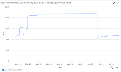

Cisco CPU datasource, top 10 by memory used (R0/0):
Cisco CPU datasource, memory usage:
The above three seem to show the same information, just presented as % and GB in different formats. Below is where it differentiates:

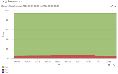

Cisco Memory Pools datasource, processor:
