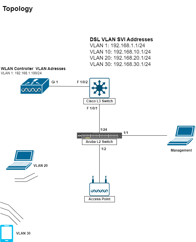

Hi everyone,
I'm currently working on a practical WiFi lab. The goal is to broadcast SSIDs mapped to two different VLANs: VLAN 20 and VLAN 30. I'm using the Cisco 9800-CL Wireless LAN Controller (WLC) deployed as a VM on VMware Workstation running on a laptop. VLAN 10 is used for CAPWAP communication between the AP and WLC. I have two scenarios:
Case 1: Using a Layer 3 Switch for DHCP
  • The Layer 3 switch is configured to provide DHCP for both wired and wireless clients.
  • I configured the DHCP pool for VLAN 10 with Option 43: hex f104c0a80164 (this points to the WLC IP at 192.168.1.100).
  • The AP port is configured as access VLAN 10.
  • The AP is in lightweight mode.
Problems encountered:
  • The AP cannot join the WLC.
    → Note: If I configure the AP port as access VLAN 1 (default), the AP is able to join the WLC successfully.
  • Wireless clients do not receive DHCP IP addresses from the Layer 3 switch.
Case 2: Using the WLC as the DHCP Server
  • Wireless clients are able to successfully receive IP addresses from the WLC's internal DHCP server.
  • Wired clients do not receive DHCP IP addresses.
  • When the Layer 3 switch is set up to route to the internet, wireless clients get IPs but cannot access the internet.
Common Issue Across Both Cases:
  • Even though ip routing is enabled on the Layer 3 switch:
    • My laptop (used for managing the lab) gets a DHCP IP but cannot ping any gateway addresses.
    • Firewall is disabled on the laptop.
    • Interfaces and VLANs are all in "up" status (show interfaces, show ip int br, show vlan outputs look normal).
I’d appreciate any insights or suggestions from the community.
Thanks in advance!

Scott Fella
The main issue is that you are using an unsupported Hypervisor.  What you need to do since you most likely can't trunk to your laptop is to setup an access port on a specific vlan.  Then you would need to look at configuring FlexConnect local switching so that your AP's would be connected to a trunk port and all traffic except for management would egress out the ap to the switch and not to the controller.
You should also connect a wired laptop to each vlan first to make sure a wired device is getting dhcp, or else you know you have to figure that out first.

[*05/12/2025 13:31:09.0666] bind-interfaces
[*05/12/2025 13:31:09.0666] interface=lo
[*05/12/2025 13:31:09.7064] chpasswd: password for user changed
[*05/12/2025 13:31:09.8064] #### board_data_init: num_slots (3), num_radios (2)
[*05/12/2025 13:31:11.0560] DOT11_TXP[0]:Domain configured: 1 class:E
[*05/12/2025 13:31:11.2759] DOT11_TXP[0]:Regdb file: /radio_fw/AP1852E_power_table_mapping.txt
[*05/12/2025 13:31:11.2959] DOT11_TXP[0]:Domain configured: 14 class:S
[*05/12/2025 13:31:12.0756] DOT11_TXP[0]:Regdb file: /radio_fw/AP1852E_power_table_mapping.txt
[*05/12/2025 13:31:12.3356] DOT11_DRV[0]: vendor_set_slot_capability: slot 0, radio_service_type 0
[*05/12/2025 13:31:12.3356] DOT11_DRV[0]: Init Radio0
[*05/12/2025 13:31:12.3656] DOT11_DRV[0]: set_channel Channel set to 6
[*05/12/2025 13:31:12.3955] DOT11_DRV[1]: vendor_set_slot_capability: slot 1, radio_service_type 0
[*05/12/2025 13:31:12.3955] DOT11_DRV[1]: Init Radio1
[*05/12/2025 13:31:12.4455] DOT11_DRV[1]: set_channel Channel set to 36
[*05/12/2025 13:31:13.3053] DOT11_DRV[0]: set_channel Channel set to 6
[*05/12/2025 13:31:13.3153] DOT11_DRV[0]: Channel set to 6, width 20
[*05/12/2025 13:31:13.3253] DOT11_DRV[0]: Channel set to 6 skipped
[*05/12/2025 13:31:13.6651] DOT11_DRV[0]: Channel set to 6, width 20
[*05/12/2025 13:31:13.6651] DOT11_DRV[0]: Channel set to 6 skipped
[*05/12/2025 13:31:13.7451] DOT11_DRV[1]: set_channel Channel set to 100
[*05/12/2025 13:31:13.7551] DOT11_DRV[1]: Channel set to 100, width 40
[*05/12/2025 13:31:13.7551] DOT11_DRV[1]: Channel set to 100 skipped
[*05/12/2025 13:31:13.8751] DOT11_DRV[1]: Channel set to 100, width 40
[*05/12/2025 13:31:13.8751] DOT11_DRV[1]: Channel set to 100 skipped
[*05/12/2025 13:31:14.9747] ipv6 gw config loop in capwap main
[*05/12/2025 13:31:16.9641] AP IPv4 Address updated from 0.0.0.0 to 192.168.10.151
[*05/12/2025 13:31:16.9741] ipv6 gw config loop in capwap main
[*05/12/2025 13:31:17.9738] ipv6 gw config loop in set IPv4 addr task
[*05/12/2025 13:31:18.9735] ipv6 gw config loop in capwap main
[*05/12/2025 13:31:19.9732] ipv6 gw config loop in set IPv4 addr task
[*05/12/2025 13:31:20.9729] ipv6 gw config loop in capwap main
[*05/12/2025 13:31:21.9726] ipv6 gw config loop in set IPv4 addr task
[*05/12/2025 13:31:22.9722] ipv6 gw config loop in capwap main
[*05/12/2025 13:31:23.9719] ipv6 gw config loop in set IPv4 addr task
[*05/12/2025 13:31:23.9919] dtls_init: Use MIC certificate
[*05/12/2025 13:31:24.3118]
[*05/12/2025 13:31:24.3118] CAPWAP State: Init
[*05/12/2025 13:31:24.3118] PNP is not required,
[*05/12/2025 13:31:24.3118] Starting CAPWAP discovery
[*05/12/2025 13:31:24.3318]
[*05/12/2025 13:31:24.3318] CAPWAP State: Discovery
[*05/12/2025 13:31:24.3318] Got WLC address 192.168.1.100 from DHCP.
[*05/12/2025 13:31:24.3318] Discovery Request sent to 192.168.1.100, discovery type STATIC_CONFIG(1)
[*05/12/2025 13:31:24.3618] Discovery Request sent to 255.255.255.255, discovery type UNKNOWN(0)
[*05/12/2025 13:31:24.3718]
[*05/12/2025 13:31:24.3718] CAPWAP State: Discovery
[*05/12/2025 13:31:25.9713] Start: RPC thread 1108962448 created.
[*05/12/2025 13:31:25.9713] ipv6 gw config loop in set IPv4 addr task
[*05/12/2025 13:31:34.8185] ipv6 gw config loop in discovery timer expiry
[*05/12/2025 13:31:36.8179] ipv6 gw config loop in discovery timer expiry
[*05/12/2025 13:31:38.8173] ipv6 gw config loop in discovery timer expiry
[*05/12/2025 13:31:40.8167] ipv6 gw config loop in discovery timer expiry
[*05/12/2025 13:31:42.8260] ipv6 gw config loop in discovery timer expiry
[*05/12/2025 13:31:44.8254] ipv6 gw config loop in Ac discovery
[*05/12/2025 13:31:46.8248] ipv6 gw config loop in Ac discovery
[*05/12/2025 13:31:48.8242] ipv6 gw config loop in Ac discovery
[*05/12/2025 13:31:50.8235] ipv6 gw config loop in Ac discovery
[*05/12/2025 13:31:52.8229] ipv6 gw config loop in Ac discovery
I don't know if you will ever get this working the way you want it or at all, but put the ap on the same vlan as the controller.  I don't think you have configured any discovery for the ap to find the controller, so put it on vlan 1 and see if it joins, if it joins, then try to move it to vlan 10 and see what happens.  At least that way you have an idea if the controller and ap can communicate and join or not.  Also if you can get it to join on vlan 1 but not vlan 10, then you have other issues.  Once the ap joins a controller, it will now of that controller ip and you should see that in the logs.
-Scott
Hi Scott Fella,
First of all thank you for your advice. I got a success with AP and WLC together on VLAN 1. It worked, the AP can join to the wlc if it has the same subnet. But i want to do it with more advance by separate management (VLAN 1) and CAPWAP (VLAN 10). But it was failed, when i plug in console cable in AP, i could see it can obtain DHCP from WLC by DHCP option 43 but when it send CAPWAP discorvery to wlc, the wlc could receive it but the problem is wlc not send a discovery reply to WLC. So that is a problem
Nó hoạt động, AP có thể tham gia WLC nếu nó có cùng một mạng con.
If the join was successful when on vlan 1, but when you change the ap to vlan 10 and it fails, that basically means that the discovery from the ap on vlan 10 to the controller on vlan 1 is not working.  This can be a firewall on your laptop maybe blocking UDP ports 5246 and 5247.  Since VM Workstation is not a supported version, it can also be something that VM Workstation is doing that is not allowing the communications.  Why not put the controller on vlan 10, no one these day's use vlan 1.  If you can't get it to work, I suggest leaving it in a working condition and getting everything else working that you want to test out.
-Scott
Rich R
Like Scott says VMware workstation is not supported so won't work "out the box" - there are some tweaks and hacks you can find if you search to make it work.
Without seeing all your switch configs not clear why but means that either your WLC's WMI is in VLAN 1 or you have mismatched VLANs across the network - eg access ports between switches instead of trunk or incorrect/mismatched native VLANs.
Your AP ports should be access (for Local Mode) or trunk for Flexconnect Mode with native VLAN set to the management VLAN (10).  The links between switches should be trunk ports (with matching native VLAN) and allowing all required VLANs.
Make sure you follow the 9800-CL setup and install guides very carefully.  Any missed steps can cause problems.
Also carefully review the Best Practices guide (link below) because there are a number of things which are specific to 9800-CL too.
And finally review your WLC config with Config Analyzer (link and details below) to highlight many common mistakes and best practice items.
To understand Flexconnect:
https://www.cisco.com/c/en/us/support/docs/wireless/catalyst-9800-series-wireless-controllers/213945-understand-flexconnect-on-9800-wireless.html
https://www.cisco.com/c/en/us/td/docs/wireless/controller/9800/technical-reference/cat-9800-flexconnect-branch-deployment-guide-og.html
A really good blog post on setting up the 9800-CL on VMWare Fusion on a MAC here https://semfionetworks.com/blog/setup-cisco-catalyst-9800-controller-on-your-laptop/
not a supported hypervisor but might help you with simalarities to workstation
Also there a good video on adding VLAN taging to VMware Workstation here which might be a missing step
https://youtu.be/FMb_IIvFQfk?feature=shared
*****Help out other by using the rating system and marking answered questions as "Answered"*****
Have you ever wanted to hack your VMware Workstation networking? In this video tutorial, I show you an easy way to add VLAN tagging to VMware Workstation which is something you can't do natively. Using a combination of client Hyper-V, PowerShell, and VMware Workstation networking, we can add VLAN
