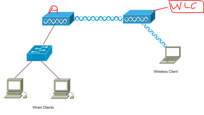

I also attached image of what it looks like. AP on the right connected to WLC and on the left is what i'm trying to configure.
It's not associating.
Basically, left AP is configured as bridge mode and other AP is on local mode.image.PNG

do you think that both APs needs to be at bridge mode?
If the AP on the left is a LWAP not autonomous then make the AP on the right be a bridge mode AP. Configure the right one as the RAP and the left one as a MAP.

AP on the left is an autonomous which is standalone AP and set as bridge (refer config), and AP on the right is connected to WLC and set as local mode
It will be non-root bridge.
