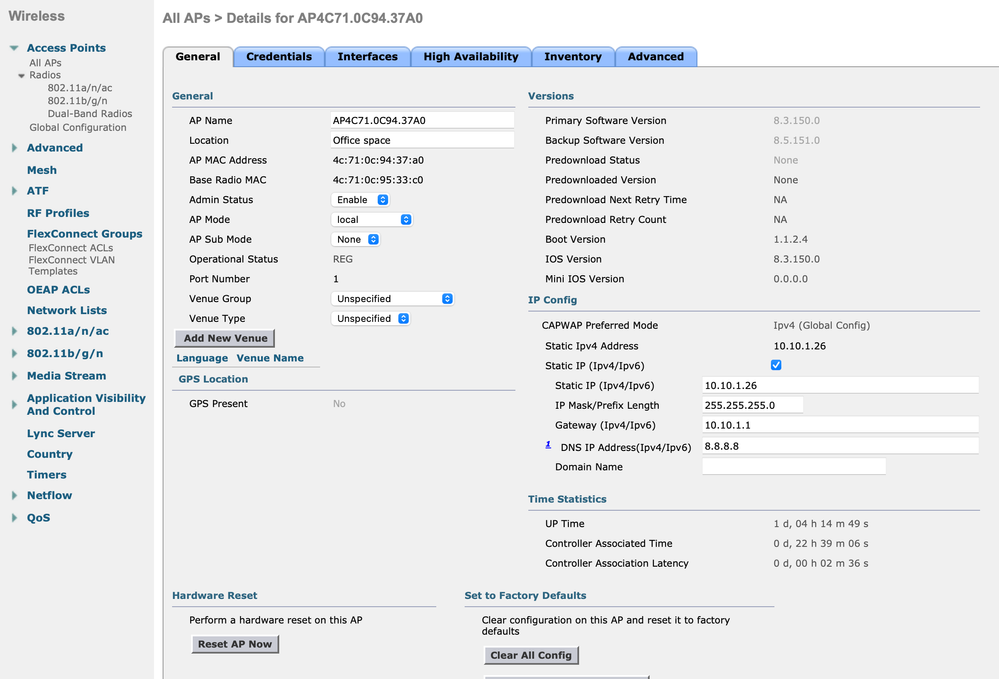

Hi.Screenshot 2023-06-08 at 14.25.55.pngScreenshot 2023-06-08 at 14.26.45.png
 i would like to see this tab
And for this tab, when you click WIRELESS it will list your AP or APs.  The AP´s hostname is a link. Click on the link to get inside the AP. And then, share the general tab
