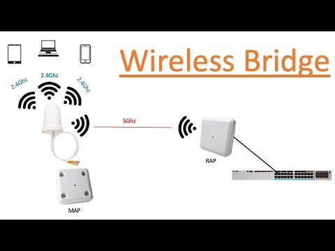

This information may also be helpful.
https://www.youtube.com/watch?v=GZCmlyo1Jjc
https://www.cisco.com/c/en/us/td/docs/wireless/controller/technotes/8-7/b_mesh_87.html
Rps-Cheers | If it solves your problem, please mark as answer. Thanks !
Mobility Express Wireless Bridge and mesh configuration. 5Ghz backhaul and clients connect on 2.4Ghz. Point to point bridge. MAP CLI Config: logging console disable show interfaces wired 0 capwap ap mode flex-bridge Video Created using: Blue Yeti Microphone - https://amzn.to/33hK29H OBS Recording
