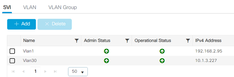

we are currently transitioning to a virtual 9800-CL WLC, hosted on a VMWare node on premise. The WLC and the FlexConnect APs are working correctly but I am experiencing a weird behavior with the interfaces.
The APs are on VLAN 1 - 192.168.2.x/24
The WLC has only the eth #2 connected
right now it's a trunk with VLAN 1 (native) and 30
on the ESXI side, the WLC is connected to a vSwitch on a trunk port
and the physical adapter vmnic2 is connected to a cisco switch on a trunk (native 1) port.
Now, from my perspective, the VLAN 30 is completely superfluous. I reach the WLC with the 192.168.2.95 IP, the APs connect through 192.168.2.95, etc...
so I was going to delete VLAN 30 from the config. However, as soon as I disable the VLAN 30,  I lose connectivity to the WLC, even from the 192.168.2.95 interface. I have to log in from the esxi console and re-enable it.
What am I missing here? Could it be something simple like VLAN 1 being tagged on some trunks and not some others (I think everything is right, but I could check further), or is there a deeper reason for a second IP?
thank in advance
F.

Thank you, the Analyzer tool is helpful, however it's not that the current config has issues, it's that I am experiencing an unexplicable (for me) behaviour when changing it. I was hoping for some tips in analyzing the overall network topology I showed in the original post to see if there's issues.

Your screenshot doesn't show any of the WLC port VLAN config on the ESX - only the top level which is labelled VLAN ID: 4095!
