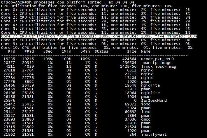

With this command, all process seems very normal except #7 CPU
After that I tried this command. There seems to be something wrong with process " ucode_pkt_PPE0 "
My question is why doesn't the system share load with other cores.
Thank you for your response.
Raise a TAC Case with EUMA or NAM/LATAM.  I am out of answers to what this process does.

Is there any problem with process ucode_pkt_PPE0?
For CPU monitoring we need to run following command multiple times. See if there are any processes showing CPU above 80% consistently and not just a spike.
sh processes cpu platform sorted | ex 0% 0% 0%
Catalyst 9800-CL and 9800-L platforms use CPU cores for data forwarding. Therefore, it is expected to see high CPU in ucode_pkt_PPE0. For those platforms to evaluate data plane performance use command:
show platform hardware chassis active qfp datapath utilization | i Load
Refer the following Cisco 9800 KPI blog for detailed explanation as which commands to run.
https://blogs.cisco.com/networking/wireless-catalyst-9800-wlc-kpis-part-1

Still no solution. I already opened TAC but he replied me that it's normal state without giving any further information.
Thanks.  I received the "it is expected to see high CPU in  one of the cores, basically this is a normal behavior and it could be on any core, you always will see one of the cores on high utilization" response as well.
I am not 100% convinced I would be getting alerts like this during the summer (we are a school that is out of session) and that this was normal prior to the upgrade.  My other thought would be why have 10 cores if only one runs at 99.7%...
Austin
Here is the full response I received.  Still not sure why an interface has a RED Alert indicating high utilization, but I asked them to share that with the UI team.  Hopefully we can blissfully ignore...  - Austin
The global figures reflect the actual overall resources, in this case you are in green numbers.
The readings are normal across the board and Cisco documentation indicates that it is expected that IOS-XE platforms show high CPU in the ucode_pkt_PPE0 process even when sitting idle.
Please refer to this article:  https://bst.cisco.com/bugsearch/bug/CSCve73211
To improve packet throughput and reduce packet latency and jitter, the data plane more aggressively polls for new packets in later releases which raises CPU utilization even at low packet rates.
Here is the same response from Cisco wireless team
Please note that the high CPU 7 Utilization in "ucode_pkt_PPE0" for 9800 IOS-XE 16.4 and higher is expected behavior to improve packet throughput and reduce packet latency and jitter, this increases the number of CPU cycles that "ucode_pkt_PPE0" process consumes at baseline even without any traffic.
The "ucode_pkt_PPE0" is often at 100% even if the box is not passing that much traffic. It is normal for that process to report high usage, it's not an appropriate metric of how much traffic is passing through.
Reference: https://bst.cloudapps.cisco.com/bugsearch/bug/CSCve73211
