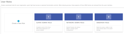

The difference in roles is that I am being assigned "NETWORK-OPERATIONS" role for production and "SUPER-ADMIN-ROLE" for the lab. I understand a custom RBAC will be required but unsure what permissions I need to request exactly following RBAC Roles

You will either need super-admin role, or need to create a New custom Role with API access under System - Users & Roles.

This most likely the issue. If this is a local user, then you would go to Menu → System → Users and Roles, then edit the user and change the role.
If this is an external user, then you would have to change the role defined in the shell profile for that user in your AAA server.
