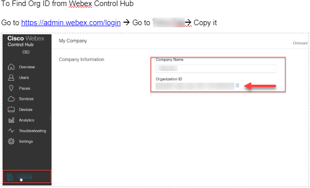

Yes it works for on-prem deployment, we have this enabled since a few weeks and it presents data for usage in Control Hub. You need to add this to you configuration, in the xml file or if you'r like us on 12.x you can use the configuration in the webUI for it.
To find your OrgID you do this.

I have tested with a couple of college's XML before completely roll out to all my users.
It proves to be working.
Tips to other users.  Copy the "Organisation ID" instead of "Company Name". I fall into that trap, and TAC was able to help me figured it out.
Thanks
Sam
Glad you got it to work @mytian
You made me uncertain about what I wrote with your note about using company name instead of organization id, so I went back to check what I wrote. I did write OrgID and showed where to retrieve it in control hub, although masked out for obvious reason. Sorry for causing any issues for you on this if there was any misleading/obscured information given. To make it clearer I updated the picture for Control Hub to highlight what to copy.
