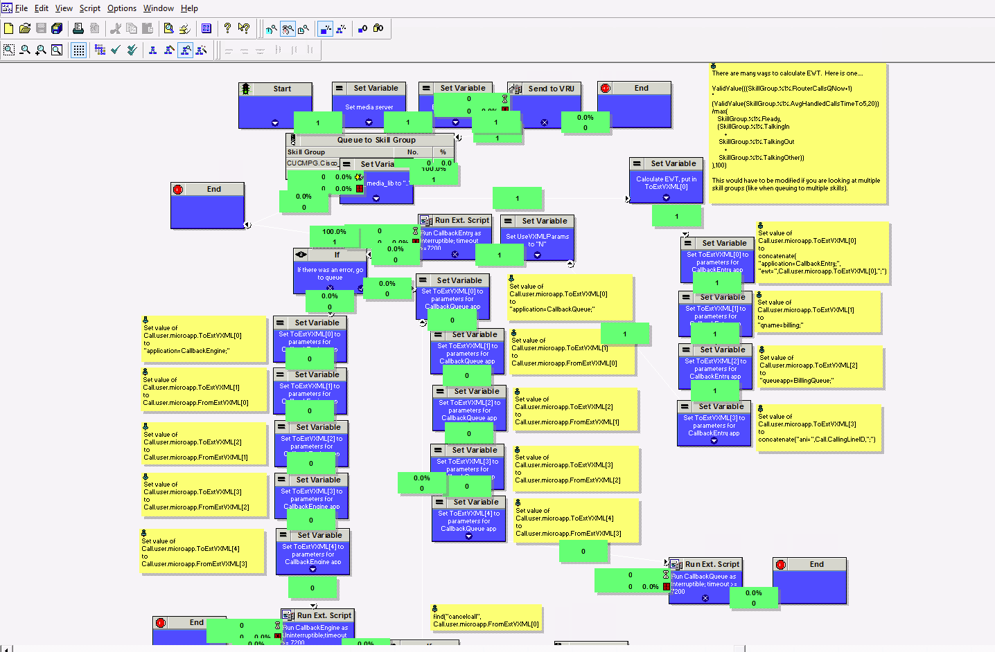

Below is the ICM Call flow from the screenshot and the CVP Log.
In looking at the CVP log, it looks like after the call gets back from VVB, its terminating and using the correlation ID to generate a new call.
On line 129 of the CVP log below, you see that its using the correlation ID to generate a new call DNIS=777777779 ANI=7207442898
From the log, the calling number is 7709406657; the called number is 7207442898. my VRU label is 7777777 (7 digits which on my CVP Opscon, i also have the DNIS as 7 digit length)

On the ICM Script, the call leg is currently failing on the initial Send to VRU. I previously had my Label and ICM Tab (OpsCon) as 11 digit. At that point when i had it as 11 digit, the call was failing at the first run ext script ("Run CallbackEntry).
CCB-icm.png--> Current State
cab.png--> Previous state with 11digit VRU Label and 11 digit ICM tab on OpsCon.

I made the recommended changes above:
CVP Ops- 11 Digit + Save and Deploy
ICM VRU Label- 11 Digit
VVB- 7777777!
Below is the screenshot of the ICM Script and the CVP Log.
ok so now Send To VRU issue is gone but you are once again back to no_session_error.
So multiple reason could be there, but the one main reason i am seeing is no ToExtVXML params reaching to CVP and that must be because one or more invalid conditions you might be having in set variable node in ICM script.
1. Hardcode the EWT value in set variable node as in attached to something like "20" or "30". if you used script available from CVP repository and did not update that node then node will use default config which will not necessarily match your system configs like Skill group name and will cause it fail having nothing passed to CVP.
