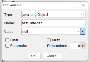

@James Hawkins
this is how you can create the object type variable (upper/lower case is important here):
Marek https://gaman-gt.com
UCCE, PCCE, UCCX, WxCC, Cisco Finesse, Custom Gadget, CVP, CUIC, CUCM
