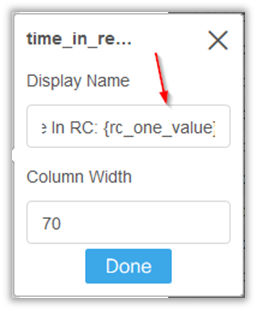

    2. For each of the "Time In RC" values you need to click the pencil icon to its right
    3. Replace the text between the curly braces with the correct reason code name
      2.       For example, if your first RC is "12 Break" you could replace the text "{rc_one_value}" with "12 Break" or just "Break"
        1. Or instead of "Time in RC: 12 break" you should shorten the entire field to just "Break"
