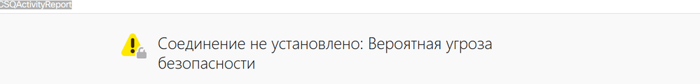

Created xml file with report permalink ,uploaded to UCCX 12.0 and added team desktop layout for supervisor under the Manage Team just for testing (<gadget>/3rdpartygadget/files/test.xml</gadget>). Permalink works fine by itself (opens normally in browser). But in Finesse with Chrome it show just table without info, with Firefox it shows certificate issue (MOZILLA_PKIX_ERROR_SELF_SIGNED_CERT). I ve uploaded the the images for both browsers.Chrome.PNGFirefox1.PNG

In case of Chrome :
Firefox:

dijarvrella
Hi there,
There are a couple recommendations I would give for this:
1. Make sure you install the certificates on the agent/supervisors computers. Typically this for an Enterprise you have the certificates of the UCCX and other components signed by the Enterprise Root CA and then they are automatically trusted from the agent/supervisors. If that is not the case please install these certificates for every agent.
2. It could be a port issue between the agent/supervisor subnet to CUIC on the specific ports. There is a requirement to have the TCP port 8444 open in bidirectional direction.
For more information on the port requirements please refer to the following link: https://www.cisco.com/c/en/us/td/docs/voice_ip_comm/cust_contact/contact_center/crs/express_11_6/configuration/guide/rcct_b_port-utilization-guide-for-uccx/rcct_b_port-utilization-guide-for-uccx_chapter_01.html
Let me know if that helps.
Thanks,
Dijar
Dijar - thanks for your pointer about certificates as this was my issue.  Was using home lab with self signed certificate.  Save the self signed as trusted root.
Thanks to both of you.
