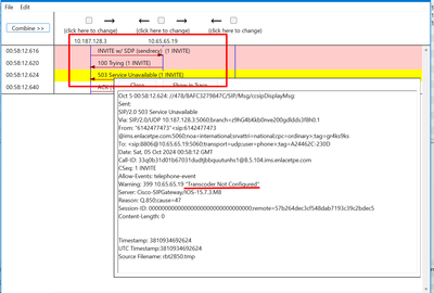

I'm having problems to redirect incoming call from sip trunk to CUE AA,
- I have a Cisco 3945 and a NME-CUE , VID: V04
- the sip trunk provider only gives the last four digits.
- sip trunk number 8800 redirects to extension 100. Works fine.
- sip trunk number 5624 redirects to extension 100. Works fine.
- sip trunk number 8006 redirects to extension 600, which is the AA. Does not work.
- When I dial 600 from any extension AA work fine.
Here is a briefing of the configuration, if you need any more info please let me know. Thank you in advance.

Could you clarify what you mean by ‘not working’? Are you getting a fast busy signal, or are you accessing the AA menu but the DTMF is not working? What exactly is not functioning?
Could you share the debug CCSIP messages and debug ccapi in/out in a different attachment?

it does not transfer the call to AA in the dial peer 600, it just silence fot 45 seconds and then it hang up the call, I will share the ccsip tomorrow.

Hi, Im attaching the files you ask
- CCSIP messages two files when a dial sip trunk ending number 8800 that works and 8806 that does not work to compare.
- ccapi in/out same two files
- as well as debug dialpeer when dial some two number 8800.
Thank you very much, let me know if you need anything-else.

I see a ‘Service Unavailable’ warning and a warning message indicating that the transcoder is not configured.
CUE supports only the G.711 codec, so you need to specify this codec on the dial-peer pointing to the CUE.

I continue to see the 503 Service Unavailable error with the message ‘Transcorder Not Configured’ in the CCSIP logs.
The codec on the dial-peer must be G.711alaw, as the ISP is sending ‘m=audio 60228 RTP/AVP 8 18 98’ in the SDP.
Your problem will be solved if you configure the transcoder.
Why did you configure ‘no voice-class sip early-offer forced’ on dial-peer 600 towards Unity Express?
