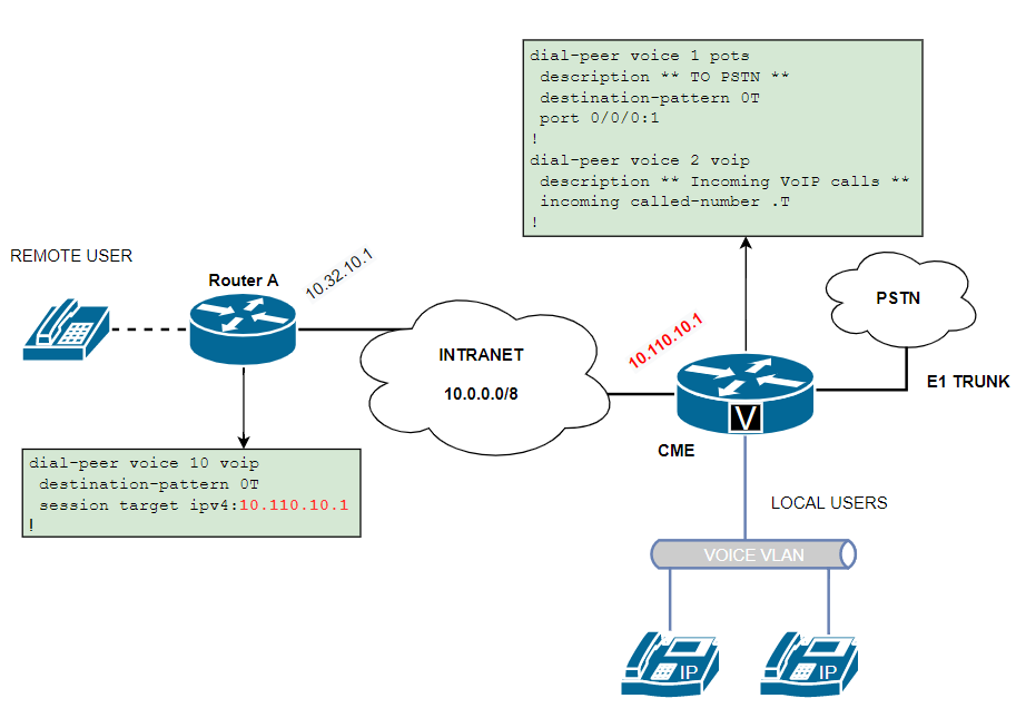

Hi everyone.
I have a proble with my VoIP solution: users everywhere (INTRANET) can make outgoing calls through my PSTN trunk.
How can I block this type of call?

I want this:
I need to ask the obvious, if you do not want to have external call capability in router A why do you have a 0T dial peer in the first place?

Hello.
Remote users need to make calls to my VoIP network. But I have no management over the remote router (A).
So, I need to prevent the remote administrator from forwarding such calls to "see what happens".
I will read the suggested documentation.
Thank's a lot.
To do this configuration without changing router A, you first need to confirm that your CME dial peer 2 is being used only for calls from router A.  Once that's confirmed there are a few ways you can play it.  Class of Restriction could be configured so that calls received on that DP can only route to certain other DPs.  However you'd need to configure that throughout your CME so as not to block your local devices.
A possible rather dirty way would be to apply a call blocking profile to your dial peer 2, blocking everything except calls to your local extensions.
In your case likely CoR would be most applicable. I would suggest that you make these changes and give it a try.

Are we sure that the trunk between Router A and CME is SIP?  We may need to match inbound DP by calling number.  However it would be nice to see the full configuration(s) and detail of the dial plan.
Good point @TONY SMITH No we do not have any information about the protocol. It was my assumption that it would be SIP, silly of me, I know that it's the MOAFU.

Hi.
First of all I would like to apologize for the delay in responding.
A case of illness in the family (COVID) took me away for a moment. But, thank God, everything is in order now.
Now, I want to thank you enormously for your contribution. I followed your suggestion and in preliminary tests it worked the way I wanted.
God bless you!
Glad to hear that you managed to sort this out and most of all that all is well with you and your loved once. Thanks for letting us know that it worked for you.
Response Signature
If you do need or want to have a CoR list on dial peer 2 you should be able to do with this.
dial-peer cor list callAll
 member PSTN
 member Internal
dial-peer voice 2 voip
 cor incoming callAll
 incoming called-number .
Response Signature
if 2XXX is the extension range configured on CME,  on router A dial-peer 10 change the destination pattern  to 2XXX that's the easiest option.
