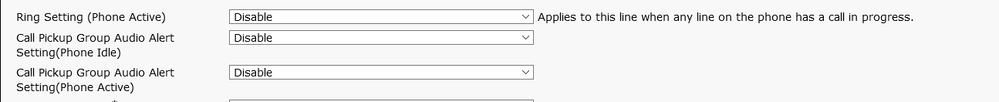

Try this, under the Line settings for the device change the Ring Setting (Phone Active) to Disable.  I have it enabled for my line and it is just a short beep.  So either that default tone has been changed or you have something else going on.  Almost sounds like a call recording alert, letting you know recording is in progress.

Check this setting on your phone line configuration page.

Try the below on line, keep below options as  disabled.

For more investigation pls go to line page on your affected phone and check below things.
1: Audible Massage Waiting Indicator Policy
2: Ring Setting (Phone Active)
3: Call pickup group setting (phone active)
