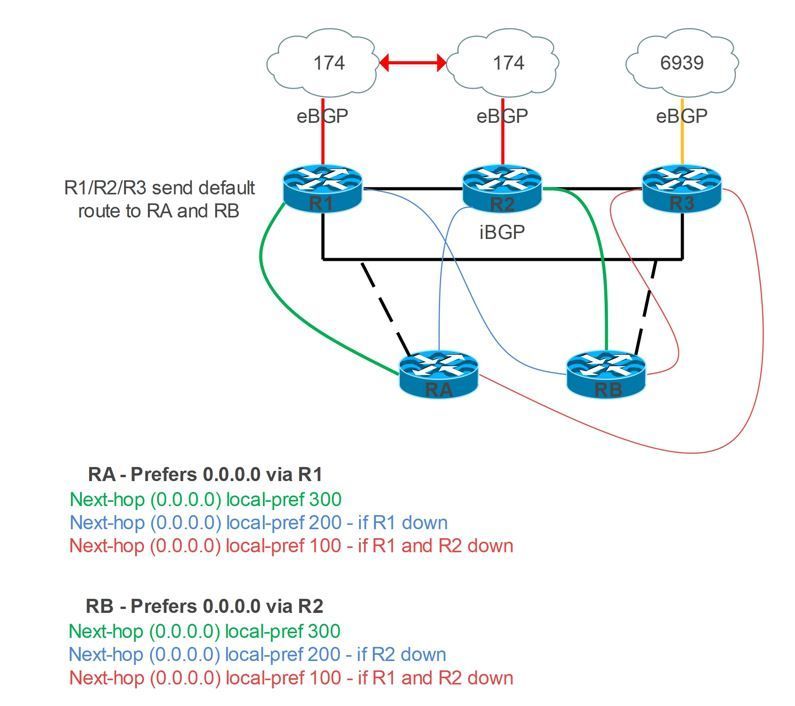

M02@rt37 @r.heitmann I just made a diagram to show the current situation : net.JPG
In the iBGP between R1/R2/R3 I have a default local-pref (100).
R1 and R2 have the same routing table from 174 but not with the same next-hop because they are two different routers.
R1 and R2 also retrieve the routing table from R3 (6939). Same thing for R3 which retrieves the routing table from R1 and R2 (174).
What do you think is the best configuration to apply ?
Thanks
