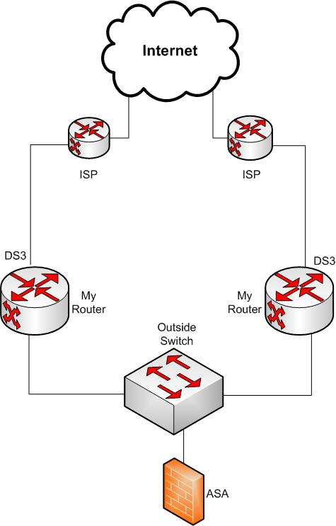

We have 2 routers (3925) connect to the ISP through individual DS3 (T3) Connection.  I want to ensure redundancy and proper load balancing.  Sample configs and recommendations would be appreciated.

Considering the size of your infrastructure and speed acces, the best solution would be BGP.
In alternative, a load-balancing appliance between firewall and routers.
In either case, I recommend you hire a reputable consultant or certified cisco partner for the job.
Please find below inputs
> Run HSRP between swich and two routers
> Run BGP between Router and ISP. I am just briefing BGP part below
  > Let's assume you have one pool of /23. Divide it into two /24 parts
  > Prepare three prefix list
    ip prefix-list ISP-A-PRIMARY permit
    ip prefix-list ISP-B-PRIMARY permit
    ip prefix-list BACKUP permit
  > Prepare two route-map for out direction
    route-map ISP-A-PRIMARY permit 10
    match ip address prefix-list ISP-A-PRIMARY
    route-map ISP-A-PRIMARY permit 20
    match ip address prefix-list BACKUP
    set as-path prepend
     route-map ISP-B-PRIMARY permit 10
     match ip address prefix-list ISP-B-PRIMARY
    route-map ISP-B-PRIMARY permit 20
    set as-path prepend
  > Put this route-map in out direction with bgp peer respectively
    neighbor x.x.x.x route-map ISP-A-PRIMARY out
    neighbor y.y.y.y route-map ISP-B-PRIMARY out
Above will ensure load sharing between two ISP for incoming traffic. For out direction you can play with local-preference . It is much depends upon what
you are learning from provider end (default-route, Full BGP, Partial table)
Hope this helps
Regards
Mahesh
