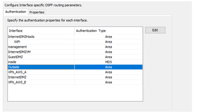

I have also noticed the Interfaces within the OSPF setup were only using inside which is where the VPN client subnet resides. The MD5 auth was set but nothing for outside where the MCR and TelephoneTechnology subnets are.. I have added these even though there is no auth. They are just defined on the old ASA/ASDM so now that matches.. would this cause the issue?
