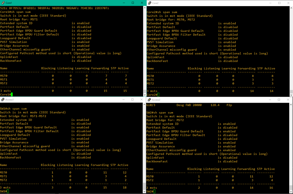

Here is output of
show span summary
which shows all switches are running MST. What else can i do?
@MHM Cisco Worldas you can also see, it looks like something has gone wrong with the MST configuration, since i have 3 switches being root bridge for instance 2 and 2 switches being root bridge for instance 1. But i really have no idea what i did wrong.
