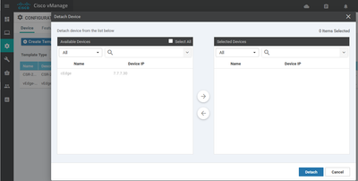

Please advice what can be done to configure my cEdge. My cEdge router is currently unreachable and I am not able to detach it from device template nor can i make changes via CLI. Thanks in advanced.
cEdge-30(config)# no ip route 0.0.0.0 0.0.0.0 10.1.15.13
cEdge-30(config)# commit
Aborted: 'system is-vmanaged': Commit from vManage is in progress. Configuration through the CLI is not allowed.
Device 'grey out', cannot be detach from device template
