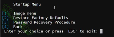

thieuhongthai
You can try this solution, I have met this problem, but i successfully solved it.
  1. Connect a console cable between your laptop and the switch.
  2. Log into the switch with a baud rate of 115200.
  3. Restart the switch.
  4. On the console screen, pay attention to the message that says "Press RETURN or ESC," and press the ESC key on your laptop to access the startup menu.
  6. You can see the interface of startup menu
    7. In this menu, you can also reset to default settings using the second menu option. To recover the password, press the number 3, and when you see the message "Current password will be ignored," press Enter, then press ESC to restart the switch.
    8. When the switch completes the startup process, it will no longer require a password to log in, but it will retain the running-config. At this point, you can create a new login account and save the configuration. In configuration mode, enter the following command: "username admin privilege 15 password Admin@2024*," with the username "admin" and password "Admin@2024*". Then, save the configuration.
