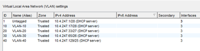

I am new to networking. I have a lab with 1 firewall, 1 L2 switch and 4 PC.
So I created 5 VLANS (1,10,20,30,40) in a single firewall interface with DHCP enabled.
What I want to know is, how should I configure the switch so that my switch can get IP from VLAN 1 and all my four PC can get DHCP and internet from each VLAN(10,20,30,40).
I am attaching a firewall interface screenshot.
Also, in my firewall I have configured VLAN1 as Untagged and rest all as Tagged. So that configuration is correct or not?FW VLAN.png

Thank you Rick and Reza for your great explanation. My lab is working now and the PC is getting the internet.
But there is a slight problem: the PCs connected to their respective VLAN can only access the firewall on their VLAN gateway.
I want every PC to be able to access the firewall from the VLAN 1 IP i.e. 10.4.247.1, which is an untagged port. How can I achieve that?
For example, if you refer to the screenshot, a PC in VLAN 40 can only access the firewall with 10.4.247.129 and is not able to reach VLAN1 IP 10.4.247.1.

So for point number 1, since this is my lab, so I only want to test if PC in different VLANs can access FW through VLAN1 or not.
For point number 2, yes I have allowed the ping in the internal network in the FW, still, I am not able to ping VLAN1 from any other VLAN.
