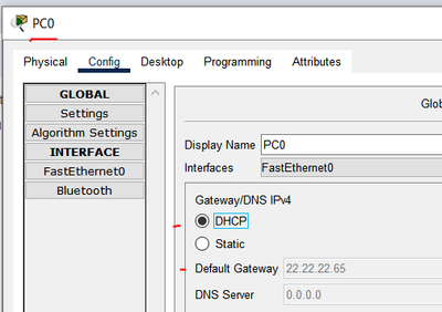

Hey there i am doing a project for myself. But i get an error: "DHCP failed APIPA is being used". How can i fix this? Thanks

Hello @guatex
you have to configure port Fa 0/6 (guneysw01)  where your DHCP server is plug:
After that PC should have IP ADD by DHCP:
Best regards
M02@rt37
