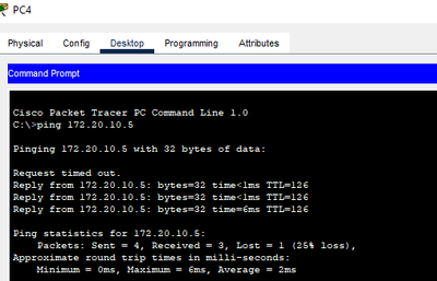

I connected two 3560 cisco-switches through their gig0/1 port. Wanted to use eigrp to make the routing connection work.
But when I do a 'show ip route eigrp' command , nothing comes up. In 'show ip route' I only see C's and no D's.
I will display the most important commands I made :
ip routing
int gig0/1
no sw
ip address 192.168.0.3 255.255.255.0 ( the other switch I used 192.168.0.2)
router eigrp 1 (in both switches)
network 192.168.0.0 0.0.0.255
network 172.20.0.0 0.0.0.255 (in the other switch it was 172.30.0.0)
got the message of a neighbor that is up.
I used 'debug eigrp packets' and 'hello'packets were sent and received by the opposite port.
So I really don't know what's wrong. I first noticed because I couldn't ping from one side of switch MLS1 to the other side of switch MLS2.

If you look at the scematic I added in my first post you will see some computers. I tried ping from pc4 to pc 6, that works, I pinged from pc4 to port gig0/1 of MLS2 and it works, and I pinged from pc4 to gig0/1 of MLS1 and it didn't. SO thats pingign from 172.30.80.5 to 172.30.80.1 and to 192.168.0.2 and last to 192.168.0.3. PC1 has 172.20.10.5

Ok, lesson learned. I only needed those vlans in that switch taht was connected to the devices that needed the vlans. They werent supposed to be in both switches.
Thanks guys. For the patience and your effort to help.
It worked !
