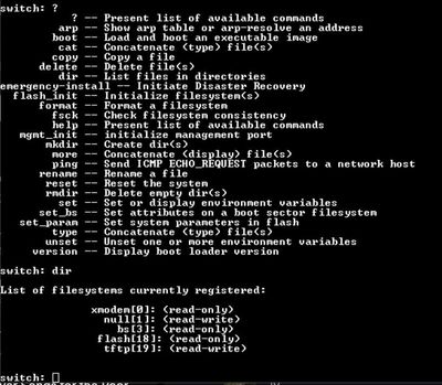

Hello and thanks in advance for the help
I have a bunch of uninstalled 3850s that were previously in a stack that I need to factory reset one by one.  The switches all boot to a password-protected prompt that I do not have the solution to.  I have attempted to use the mode button procedure to do this but it does not work.  I am unable to get to ENABLE mode and the flash appears to be read-only.
Any help you can provide would be appreciated.
Thanks
Get in the switch prompt again and run the following command
Switch: SWITCH_IGNORE_STARTUP_CFG=1
Switch: SWITCH_DISABLE_PASSWORD_RECOVERY=0
Switch: BOOT=flash:packages.conf
Switch: boot

Hi @jrichards
 Can you try this sequence?
flash_init
dir flash:
boot flash:<ios in the flash>
I am new to this so I am not 100% sure which specific file is the IOS.  Here is what I am looking at:
boot flash:packages.conf
Just confirm the name as the print Visibility is not good.
The switch brings me to the previous owner's password-protected login screen at the completion of the boot when I run the sequence you provided.
Switch: boot
OK so I ran this process and received an error on the second command as the file is read only.
The switch booted to the SWITCH> command prompt where I was able to enter EN mode.  I don't know where to go from here.
Wait....you are in privilege mode here! what else you need more?
I should have rebooted at this point to check, I am now in the initial configuration dialog.  Problem solved.  Thank you for the help!
