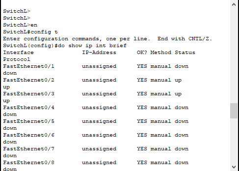

Neither PC's will ping the Router.
2.) Switch 1 does not have vlan 20 on it because the switch port connecting to the next switch is trunked. Cisco Packet Tracer - C__Users_Robert Lexie_Desktop_Network Academy 1.1.pkt 8_7_2018 10_53_29 AM.png
