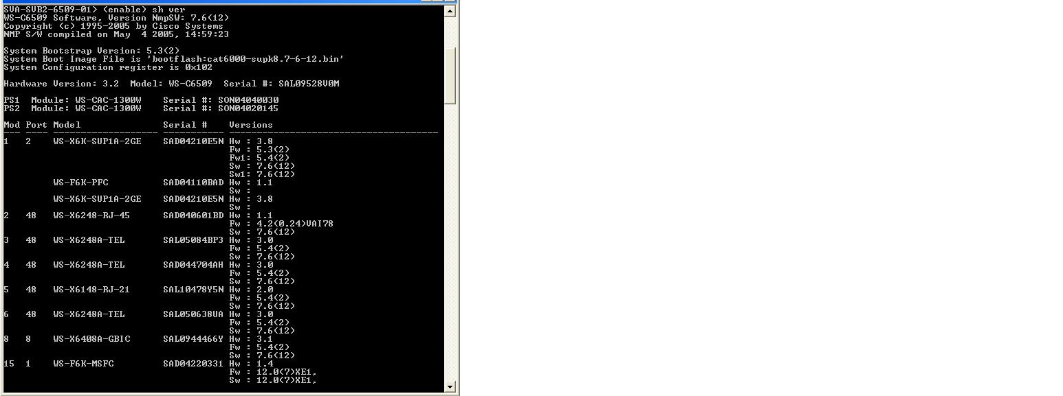

We're running a CATOs setup (soon to be straight IOS. Version info is in attachment.
